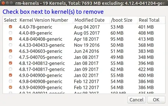

"I prefer a "user-friendly" way to work with my computer instead of using cryptic terminal-commands"
rm-kernels
rm-kernels fits your "user friendly" requirement. It's a bash script you can quickly create. As described in Ask Ubuntu answer: How to selectively purge old kernels all at once
