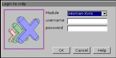

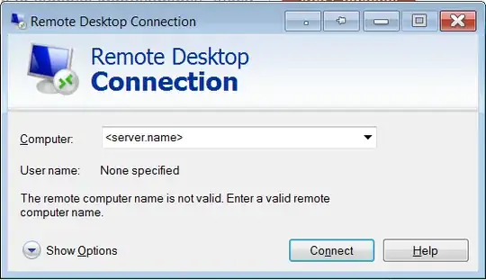

I installed xrdp
sudo apt-get install xrdp
If you are connecting from Ubuntu then ssh -X username@server
If you are connecting from windows, then you can use Remote desktop connection

1.
It depends, but I would say yes. I myself, have come across this same problem and arrived at xrdp. I too have a ubuntu server that has xrdp installed on it and I'd say it works very well.
2.
While I was looking for a solution myself, I came across this article here, which I found very helpful. Also, as @mikewhatever has also pointed out, you don't need the same desktop environment on the connecting computer. The only reason why you need a different desktop environment in the server is because XRDP doesn't support the default environment.
3.
It's automatic*, you just need to enable the ssh tunnel option in your remote desktop client.
*I didn't need to do anything fancy, I just followed the steps in the linked article.
Hope this helps you!
