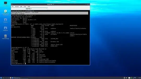

dus lubuntu-22.04.3-desktop-amd64.iso
and tested it in a Lenovo V130 in UEFI mode with secure boot. It works, as illustrated with the following screenshot,

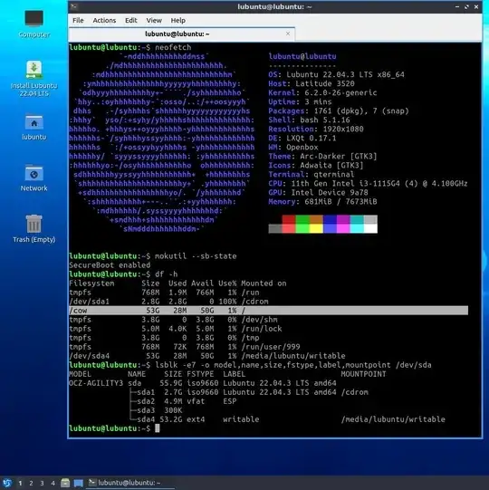

It works for me with a persistent live drive made by mkusb-plug too, as illustrated with the following screenshot,
Edit: added test in Dell Latitude 3520
It worked for me to boot a persistent live system made by 'mkusb-plug' in a Dell Latitude 3520 with an Intel generation 11 i3 CPU (so rather new and with a modern 'tight' secure boot system). See the following screenshot,
