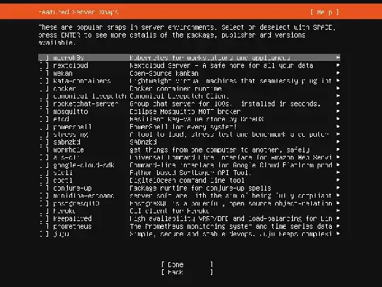

One "official" place to get a list of packages available during installation (but not preinstalled unless you choose to) is the "Using the installer step by step" guide for Ubuntu Server.
In this guide you'll find this image, which shows packages that you are presented for during installation: (which also means these are not preinstalled, unless you choose to)
And now for the caveat: Since 20.04, these are all Snap packages. It seems Canonical are indeed pushing snaps in front of regular .deb packages.
