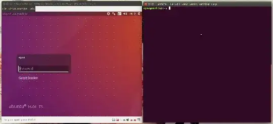

4. Demonstration:
5. References and more examples are available here.
