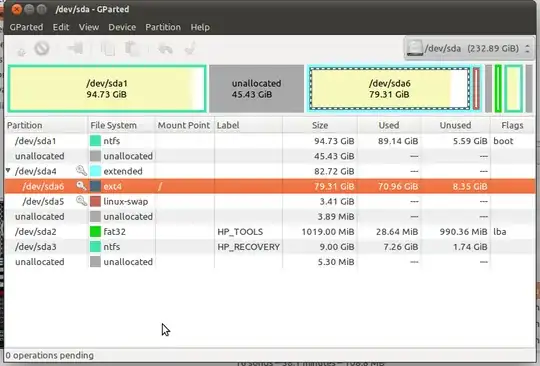

A screenshot of my current disk. (With the livecd there's no 'key' icon after sda6)
a screenshot of my current disk
My first thought was just right click on sda6 → move/resize → done. Unfortunately I cannot resize or move the partition. However I can resize the NTFS partition.
I guess it is because the extended sda4 partition is locked. I couldn't see an unlock possibility though…
So how do I resize the ext4 partition anyway, probably by unlocking the extended partition, but how?

You cannot resize a mounted filesystem, that's why you see a lock icon.
You were doing well, you booted into a Live CD and resized the NTFS partition.
Now you need to enlarge the Extended partition, partitions "inside" that extended partition cannot "escape" outside.
  1. Make sure that /dev/sda6 is unmounted. If a lock icon is visible, right click on it and choose for Unmount
  2. Make sure that the swap partition /dev/sda5 is unmounted. Right click on it and choose for Swapoff
  3. Select /dev/sda4 and choose for Resize. Use the free space on the left side
  4. Select /dev/sda6 and resize it on the right side
  5. Apply the changes and you're done.

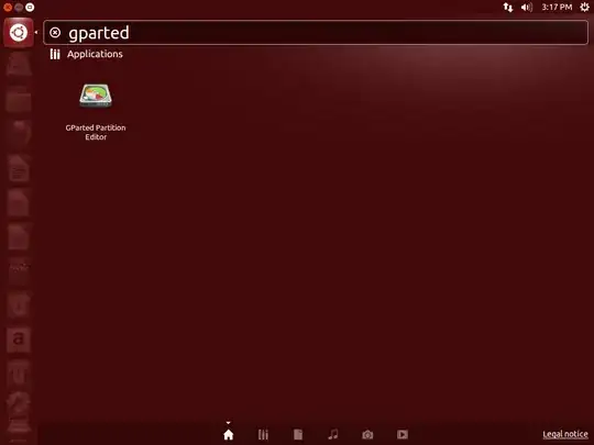

Press Start and type Gparted:
open gparted

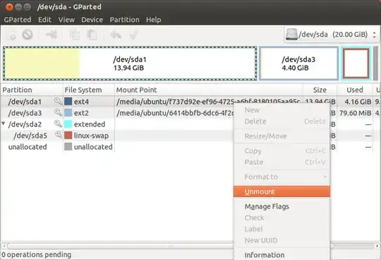

Once you open the program you will see a list with your partitions. Now to make any changes, we have to unmount the partitions we want to edit. Right-Click on the partition, and choose Unmount:
unmount partition

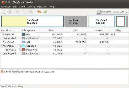

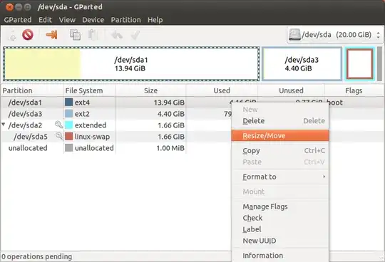

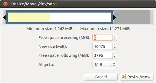

Let's assume that I want to decrease the size of sda1 and add it in sda3. Right-Click on sda1 and choose Resize/Move
A new windows will pop out were we can make our changes. Now to decrease the size, drag the Right arrow to the left. You can also type a custom value next to the option New size (MB):. Once you choose the new size click on the button Resize/Move

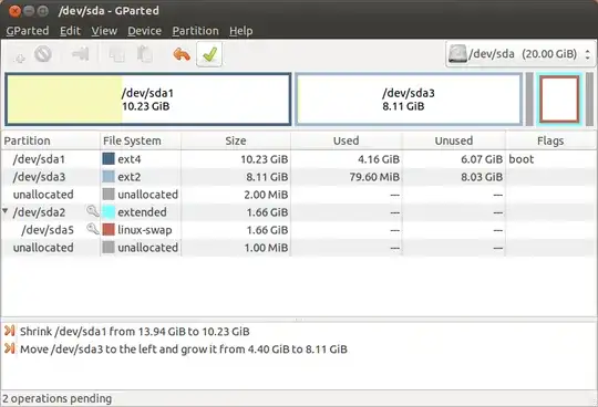

Now a new box will appear with the label unallocated. We will now add this free space at sda3 partition.

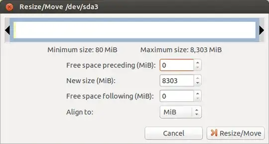

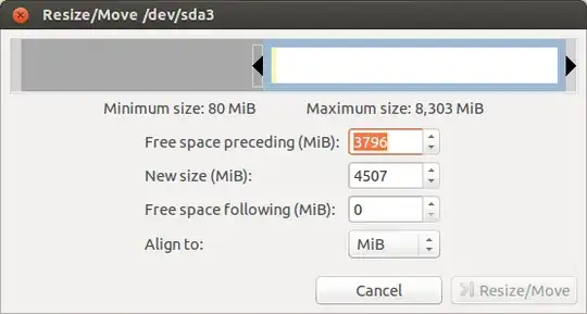

Right-Click on sda3 and choose Resize/Move
Drag the left arrow to the left as shown below:
Hit the button Resize/Move to submit the change.
Finally, click on the "tick" button to apply all your changes.
