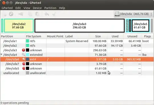

One issue that I've been facing for few weeks now is that the Ubuntu partition is running out of space (I setup only 6GB of space for it and now I have less than 300MB available).
I tried to follow the instructions which I've found in some threads here, but non worked.
I'm trying to add the 3.79GB (sda7) to Ubuntu partition (ext4).
When I click the right button over ext4, the only options I have are [Unmount, Manage flags, Information)... and while sda7 only [Delete, Format to, Manage flags, Information) are available.
Can anyone tell me, what am I doing wrong?
