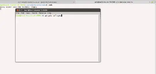

Defragmenting ext4 file system in linux I am adding this answer to also show how we can find about various built-in Linux tools to do some commonly done operations. you
Also, note that you need to do as super-user only if you want to defragment without unmounting.
Using apropos command
e4defrag -vc /path #verbose output with count
