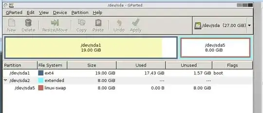

This has been asked here, Why I'm seeing a lock besides the partition I'm trying to modify with gparted?, but I'm having problems.
These two partitions both have ext4 as their file system. They are both unmounted. Swap space is swapped off:both
I want to extend sda1 with sda3. I have no data on sda3

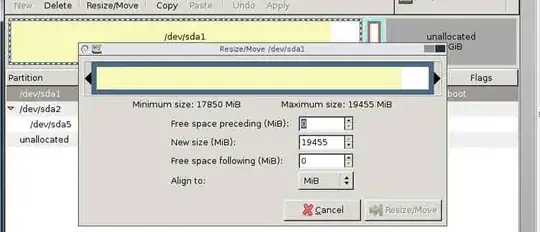

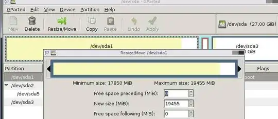

However, when I click resize/move on sda1 I get this:
sda1
It's as big as it can go!
It's the same story if sda3 is empty unallocated space:
unallocated
sda1 is as big as it can be. How do I extend it into the unallocated space?
Worth mentioning that the screen shots are from a liveCD containing GParted's iso.

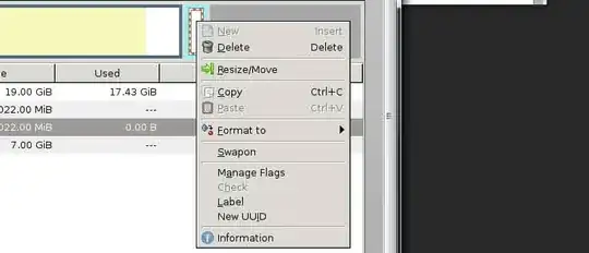

I gather I need to move unallocated space next to the drive that needs to be extended. I cannot click and drag sda2 containing swap space an inch.
This liveCD shouldn't be using it but it's the best answer I've had:
sda5
I can extend the swap space no problem. What does this mean?
extended swap
Starkers

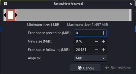

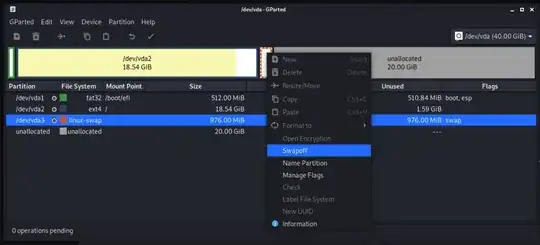

I was able to do this in my VM like this:
  • Right click on the swap partition in between and select Swapoff enter image description here
  • Right click on it again and select "Resize/Move"
  • Drag that swap partition all the way to the right and click Resize/Move. enter image description here

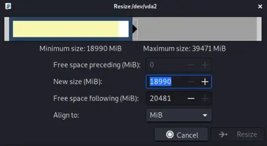

  • Right Click on the full partition and select "Resize/Move"
  • Now you will be able to resize it and make use of the unallocated space enter image description here
  • Click "Resize" and "Apply Changes" (✓ button).
