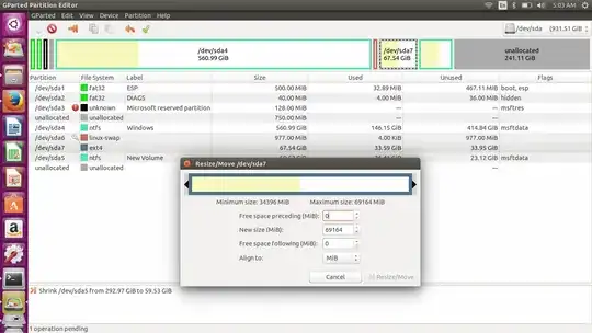

I wish to increase the disk space of my Ubuntu OS (ext4) drive from 70 GB by around 200 GB. Now , I followed the steps on this link and successfully decreased the partition for my D drive from 292 GB to 54 GB. So it created an unallocated space for 241 GB as shown in the screen-shot.
Now, I wish to increase the disk space of my Ubuntu drive(ext4) from 69GB till as much as I can consume from the unallocated space.
When I right click on ext4 -> Go TO Resize -> It shows me below screen. It does not shows an option to increase the disk space. I can only SHRINK it. However, I wish to grow this space. Can anyone tell me where am I going wrong ? TIA :)
My Gparted GUI
Looking at the image, you need to move your /dev/sda5 to the end of the drive putting the unallocated space between /dev/sda7 and /dev/sda5. Then you should be able to resize /dev/sda7 to the remaining unallocated space.
To move the partition, make sure that it is not mounted. Right click the partition /dev/sda5 and choose Unmount. It didn't look like it was mounted in your image. Then right click it again and choose Resize/Move. Then just drag that partition all the way to the right.
