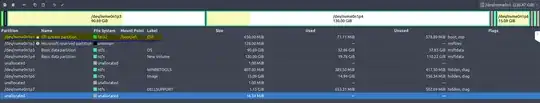

I have both windows and ubuntu installed in my computer, and I wants to extend my ubuntu root space, but I have some complicated problems, here is the image: My boot location
as you can see, my boot is installed with my windows boot. On the other hand, my ubuntu is installed in another disk, and is shown here:

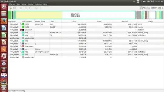

my ubuntu location
I'm a new to linux, Since it is not LVM, I think I should resize my root by Gparted liveCD, deleting dev/sdb3 and resize root to include unallocated space, but:
1) I don't know whether deleting /dev/sdb3/ with label "boot, esp" will cause any problem?
2) Since bootloader is in other disk, will I lose bootloader?
3) I have checked the existing post in askubuntu, and in here
Why I'm seeing a lock besides the partition I'm trying to modify with gparted? it said that resizing disk space in gparted is enough and just reboot, but in some other post, e.g Extend root partition with unallocated space on the left, it is required to rebuild bootloader by myself, which one is correct??
