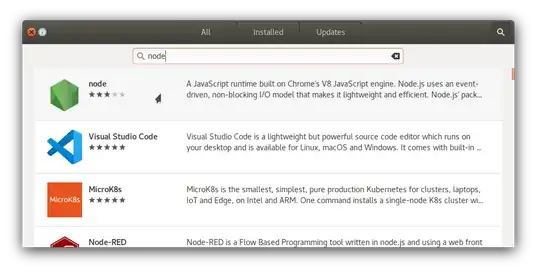

Install the snap package
The easiest method to install Node.js on Ubuntu is to use the snap package. Just search for node on Ubuntu Software store and install the first one.
Node.js on Ubuntu Software
Or if you prefer command line:
sudo snap install node --classic
