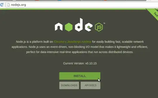

Node.js can easily be installed from its source package located on the front page of nodejs.org. It allows you to build the most compatible package for install.
Note: I recommend not installing the Linux Binaries for your system architecture (ie. x32, x64) as they are missing components you may require such as NPM.
Node.js Front Page
You can right click on the INSTALL button to copy the source package link and do the following also in your terminal console.(Example shows how to install current version as of 07-31-2014)
