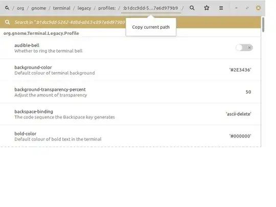

To get the "path" use dconf-editor to locate the profile and click on the profile name and you can then "Copy current path" - see attached screenshotenter image description here
