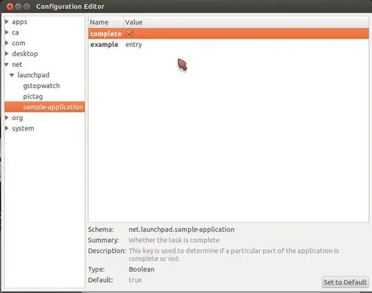

You can find the settings by installing the dconf-tools package, and running dconf-editor. Then navigating to the node defined above. The node in the XML in the question (/net/launchpad/sample-application) would be here:
dconf-editor window at the path /net/launchpad/sample-application
