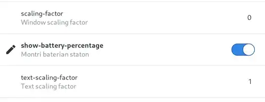

dconf-editor also uses schema data
Despite its name, dconf-editor does show both modified and default settings, including which are default and which are explicitly set:
screenshot from dconf-editor /org/gnome/desktop/interface/
and is fully aware of schema info:
screenshot from dconf-editor /org/gnome/desktop/interface/text-scaling-factor
