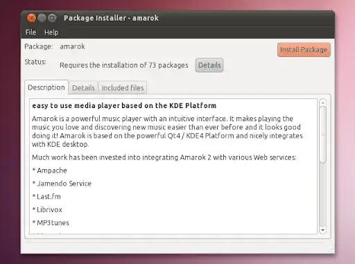

You can install gdebi-core, which is the command line version of the GDebi package installer from 10.04 and earlier. In the newer versions of Ubuntu, the Software Center is used to install debs, which doesn't have a command line equivalent.
To install a deb package using gdebi, just run:
sudo gdebi my_package_1.0.deb
45
Gdebi
gdebi installs a deb package and its dependencies. To use it run:
sudo gdebi package.deb
In newer versions of Ubuntu, this is not installed by default, so you will need to install it from the repositories.
See man gdebi for a full list of options.
gdebi is the command line equivalent to the graphical tool of the same name that used to be included by default in Ubuntu. The command for the graphical tool is gdebi-gtk and has similar functionality:
gdebi-gtk
