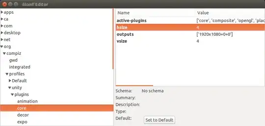

I'd like to change org.compiz.profiles.unity.plugins.core -> hsize and -> vsize from command line.
I thought I could use
gsettings set org.compiz.profiles.unity.plugins.core vsize 4
but then I've got an error message:
No such schema 'org.compiz.profiles.unity.plugins.core'
Is it possible at all? The setting can be clearly seen, as on the attached screenshot.

You can use dconf:
To get the current values:
dconf read /org/compiz/profiles/unity/plugins/core/hsize
dconf read /org/compiz/profiles/unity/plugins/core/vsize
To set new values:
dconf write /org/compiz/profiles/unity/plugins/core/hsize 2
15
The schema is org.compiz.core and it is a relocatable scheme (this makes it possible to support multiple profiles for Compiz).
For relocatable schemes you have to add the path if you use gsettings. It's /org/compiz/profiles/unity/plugins/core/ for the Compiz profile unity:
gsettings set org.compiz.core:/org/compiz/profiles/unity/plugins/core/ hsize 4
gsettings set org.compiz.core:/org/compiz/profiles/unity/plugins/core/ vsize 4
