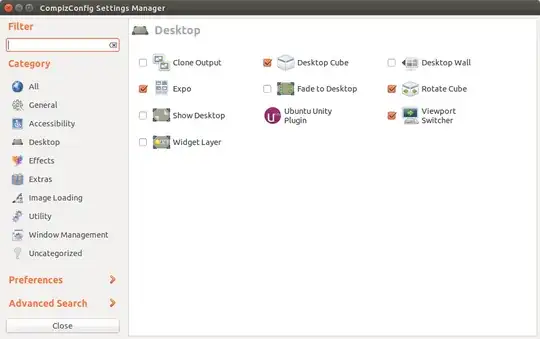

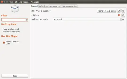

Open CompizConfigSettingsManager (ccsm) and change settings to match the following:
ccsm-1
ccsm-2

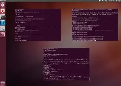

Open terminal 1
Use the keyboard shortcut CTRL-ALT--> (right arrow) to go to the next desktop to the right.
Open terminal 2
Use the keyboard shortcut CTRL-ALT--> (right arrow) to go to the next desktop to the right again.
Open terminal 3
Use the keyboard shortcut CTRL-ALT-<- (left arrow) to go to the previous desktop containing terminal 2 (or twice to get back to terminal 1)

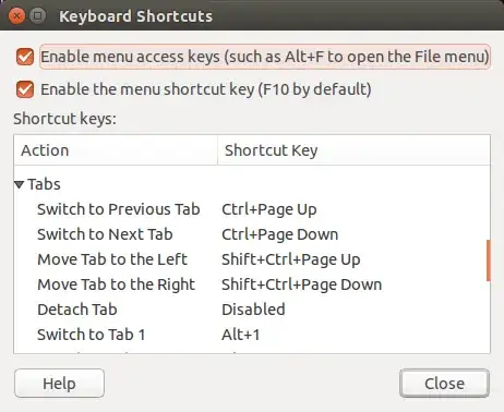

Rather than opening seperate terminals (or workspaces) for your numerous activities you can also use tabs in gnome terminal. Shortcut keys for tab switching are available from terminal preferences. See below:
terminal-prefs

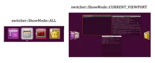

Here you can clearly see that this is exactly the function what we were looking for. The upper part is responsible for the switching of the viewport modes:
Show modes
This toggling appears each time we move into a group of Apps or if we move out of the group. optionGetAltTabBiasViewport indicates when this happens. Then GetAltTabIcons is involved in order to get the right icons. And finally the Show function with the SortMode::FOCUS_ORDER is called to display our sorted icons. SortMode is an enum:
