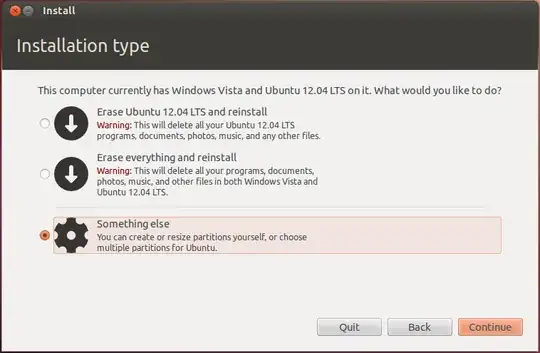

When you get to the point where you have to choose where to install(“Installation Type”),
choose “Something Else”. A new screen will pop out letting you choose where to install Ubuntu, format, make partitions, etc. Follow carefully the bellow:
  1. Choose and format the smaller disk (SSD) as ext4 and mount point / to install Ubuntu
  2. Choose and format the bigger disk (HDD) ext4 to just store media. Assign it a mount point /bigdrive. Alternately assign mount point /mnt/bigdriveor /media/bigdrive. See Why have both /mnt and /media? for more explanations on these alternates. If you use either of the alternates, modify following steps accordingly.
  3. Create a Swap partition at the end of the HDD and assign it the Swap format. It does not need any mount-point.
  4. Finish install and reboot.

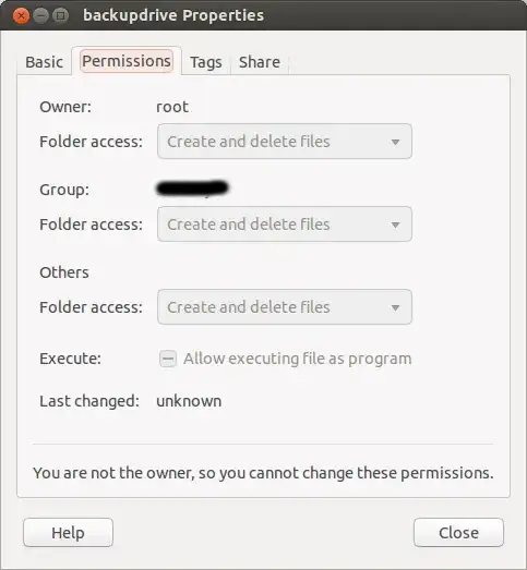

If you cannot create folders and files in the bigdrive follow these steps to fix the write permission.
  • Open terminal by pressing Ctrl+Alt+T and type
    gksudo nautilus
If this does not work, see How do I start Nautilus as root?
  • Enter your password at the prompt.
  • Within Nautilus, go to File System and find the bigdrive folder icon.
  • Right click on and choose Properties.
  • Go to the Permissions tab.
  • Make sure the Group and Others can Create and Delete Files.
