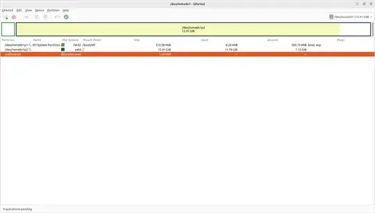

Been using Ubuntu for years but with old computers with big hard drives. New computer has a standard hard drive and a solid state as well. After install(Ubuntu 22.04.1 LTS) it put OS on the SSD which is nice cause it loads super fast. But recently it keeps saying system is full. But Disks shows two partitions but overall it says it's 1.2 percent full. I'm sorry but I don't know much about partitions and how that all works but I'd like to have all my files on Home put on the hard drive and then I'd like the SSD to just be used for the operating system and other programs. Can anyone take a minute and teach us about partitions and how I can get this right. Appreciate any help!
GParted looks like this:
Sorry if I'm doing this wrong, first time asking a question, but someone asked for this:
