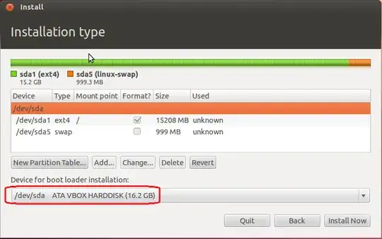

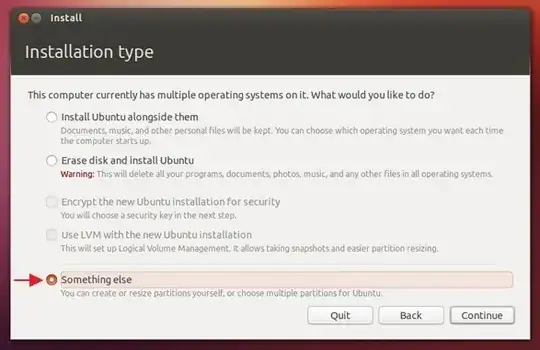

When the wizarad asks you what you want to do, choose "Something else" option.
Then you can manually allocate space for your partitions manually.
The "core" is called ROOT in linux. It is indicated as /.
Mount it on your SSD.
Then define / home partition for your HDD.
