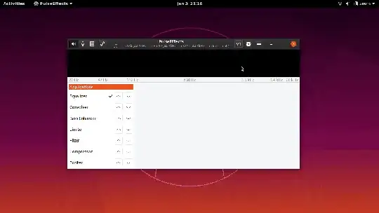

Screenshot: enter image description here
For example, if you have 3 profiles like V1, V2 & V3 and you would like to select profile V1, you can run the below command
gsettings set com.github.wwmm.pulseeffects last-used-preset 'V1'

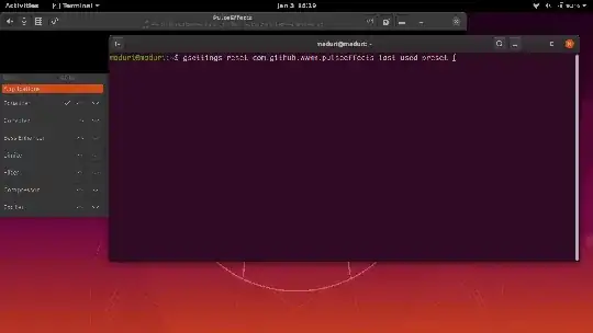

screenshot
you can create a script with below content and call it with a shortcut you wish.

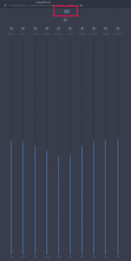

screenshot
Courtesy by @MichalPrzbylowicz for toggling on and off
dconf write /com/github/wwmm/pulseeffects/sinkinputs/equalizer/state true
dconf write /com/github/wwmm/pulseeffects/sinkinputs/equalizer/state false
