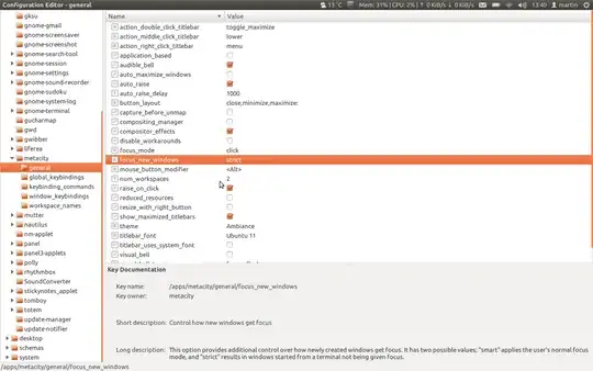

You can try setting focus_new_windows from smart to strict. You can either use gconf-editor and go to /apps/metacity/general and change the value of focus_new_windows from smart to strict, like here:enter image description here
Or you can use the command line:
gconftool-2 --set /apps/metacity/general/focus_new_windows --type string strict
If that still doesn't help, you can also change auto_raise_delay from 1000 to 0 in aforementioned gconf-editor (see screenshot).
See also here.

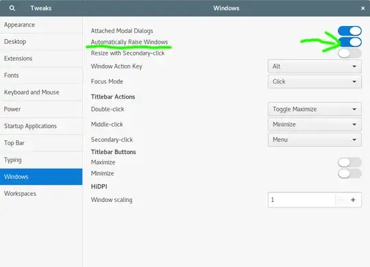

This can now be done within Tweak Tool which is included with Gnome Shell. You no longer need to use extensions or dconf-editor.
Under the "Windows" section, slide the switch over for "Automatically Raise Windows".
This setting will make windows popup in focus, and will also get rid of the "application is ready" notification.

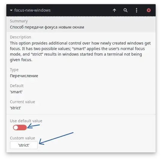

  1. use gconf-editor
  2. go to /org/gnome/desktop/wm/preferences/focus-new-windows
  3. set property: "strict"
  4. apply changes
