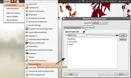

Assuming you're using the default Ubuntu Gnome desktop: You need to add your local host addresses to the ignore list in the gnome proxy settings:
alt text
