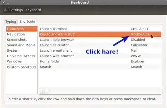

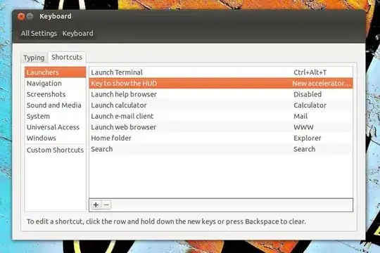

Open the System Settings application either by going to Session Indicator in Unity panel, or by searching for System Settings using the HUD.
Then go to Keyboard > Shortcuts > Launchers. You can redefine the HUD key with the Key to show the HUD option. Pressing Backspace will disable the HUD shortcut altogether.
Screenshot of Keyboard settings window, in the Launchers section
If you set it to Alt manually, the setting distinguishes between the left and right Alt key. So if you want to maintain general behaviour and still use Alt combinations, this may be an alternate solution for you.

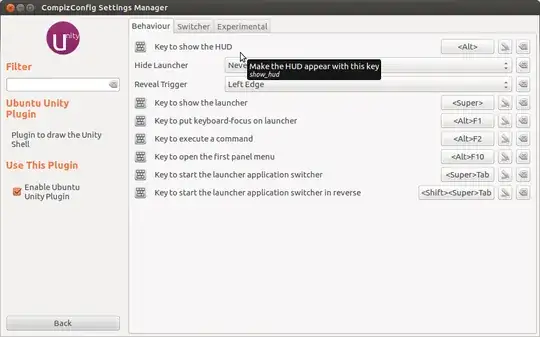

You can use compizconfig-settings-manager Install compizconfig-settings-manager to change the key used to show the HUD.
To install it, run the following command in a terminal:
sudo apt-get install compizconfig-settings-manager
After installing it, open it (ccsm) and go to Ubuntu Unity Plugin.

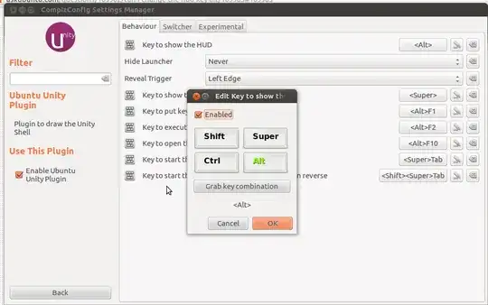

Click on the button for the option Key to show the HUD and a dialog similar to the one shown below will appear.
Click on Grab key combination and press your desired new key combination and press enter. After that, click on OK button and the new key combination will trigger the HUD from now on.

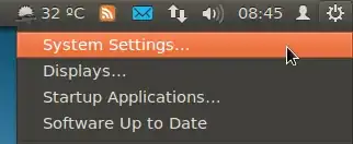

Well it's Called HUD. The new feature of Unity.
To prevent it from appearing, you can disable its key binding in keyboard shortcuts.
Open system settings by going to Session Indicator in Unity panel.
In system settings select Keyboard. Under Shortcuts tab, Click on `Key to show the HUD. and press Backspace to disable it. That's it!
