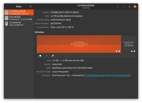

I have a secondary internal HDD formatted to ext4. How can I enable full permissions so that I, other users, and the Samba network can read, write, and execute from the hard drive? Using Ubuntu 19.04.

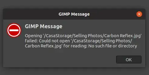

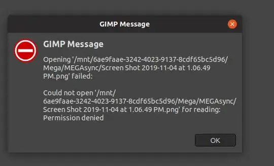

Problem: Currently on the second hard drive I can access documents and create and delete files in nautilus file manager. But I cannot edit files directly from apps.
For example, if I try to edit a photo in Gimp, I receive an error message that "permission is denied". This applies across all apps. Photo attached.

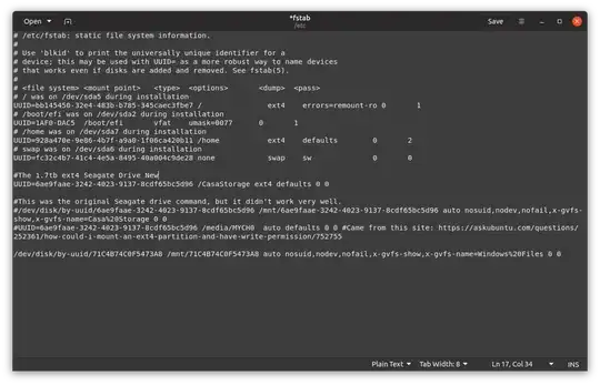

Current State: Every time I need to use a file or upload to an app (such as the Wordpress gallery), I have to copy the file to my primary OS HDD and use it from there. My current Fstab settings are:
#The 1.7tb ext4 Seagate Drive
/dev/disk/by-uuid/6ae9faae-3242-4023-9137-8cdf65bc5d96 /mnt/6ae9faae-3242-4023-9137-8cdf65bc5d96 auto nosuid,nodev,nofail,x-gvfs-show,x-gvfs-name=Casa%20Storage 0 0
I have read tutorials, videos, and AskUbuntu responses, but I can't seem to make it work.

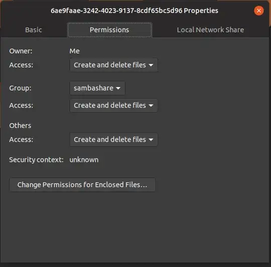

Error Message
Permissions Settings

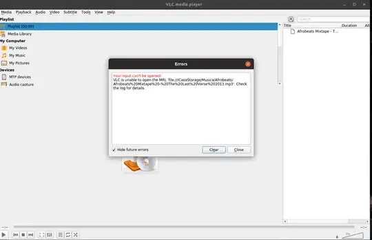

NEWEST SCREENSHOTS Files from the drive are still not accessible by certain applications. While GIMP is one application that can't access the files from the external drive, other programs like VLC can't open the files. I also can't upload to the Wordpress gallery in a web browser. It's mysterious, but hopefully there's an answer out there.

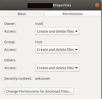

  • Right click on and choose Properties.
  • Go to the Permissions tab.

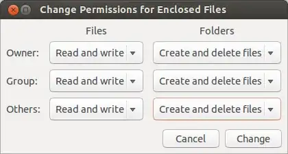

  • Make sure the Group and Others can Create and Delete Files.
  • Click on "Change permissions of enclosed files" button and make sure it looks like this:
Edit /etc/fstab
Let us make a copy of the original fstab file before we start editing:
sudo cp /etc/fstab /etc/fstab.old
To edit the /etc/fstab I use nano:
sudo nano /etc/fstab
Comment out the existing lines related to the internal big drive by putting a # at the beginning of the line like this:
#/dev/disk/by-uuid/6ae9faae-3242-4023-9137-8cdf65bc5d96 /mnt/6ae9faae-3242-4023-9137-8cdf65bc5d96 auto nosuid,nodev,nofail,x-gvfs-show,x-gvfs-name=Casa%20Storage 0 0
Add the following line:
UUID=6ae9faae-3242-4023-9137-8cdf65bc5d96 /bigdrive ext4 defaults 0 0
Note: the UUID is unique to each partition. So everyone should use the correct UUID for their own hardware. Do not copy it from here.
Press Ctrl+O followed by Enter to save the file and Ctrl+X to exit nano.

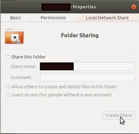

Step 1 Open Nautilus normally and navigate to / from + Other Locations on the left pane. Right click the /bigdrive folder icon and choose "Properties" and click on the "Local Network Share" tab:
Check the box "Share this folder."
You may also want to check the other two boxes "Allow others to create and delete files in this folder." This will allow you the desktop Windows user to create and delete files on this folder.
The "Guest Access" check box is self explanatory. This may be useful if your Windows userID is not exactly the same as your Ubuntu user ID.

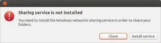

It may tell you Sharing service is not installed:
Click "Install Service" and let it install the software by providing the password when it prompts. You may be prompted to install more software like libpam-smbpass. Install all the software. It will ask you to restart services and click Yes.
Step 2. Go to the permissions tab and make sure it looks like this:
Now you should be able to edit files created in Ubuntu in the /bigdrive folder.
