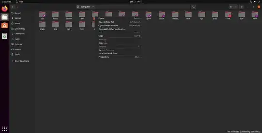

Distributions such as Ubuntu Mate or Mint make it easy: I can right click a folder and then a context menu appears with options such as "open as administrator". From then double-clicking a text file opens it in gedit with elevated privileges.
However, I can't find such an option in the default Unity version of Ubuntu:

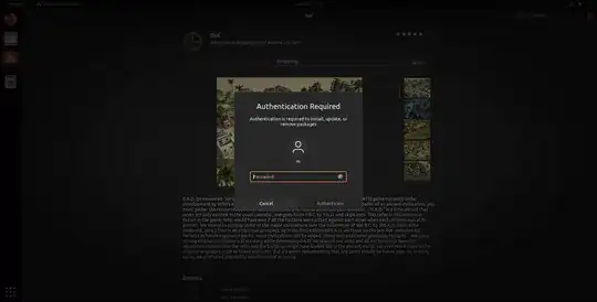

  • I recall some say that it is ill-advised to run GUI tools with elevated privileges at all. This doesn't seem to be the case, however, since some default GUI tools themselves ask for elevation, Ubuntu Software being perhaps one of the most prominent examples:
Is there a way to run Nautilus or Gedit with elevated privileges?

You can easily have a right-click menu that allows to open a file with root privileges by installing a package nautilus-admin. This nautilus extension adds two right-click menu options. One of these allows you to open a file as root for editing in gedit. The other entry allows you to open a nautilus window with root permissions.
The package is included in the standard Ubuntu repositories and can be installed with the command
sudo apt install nautilus-admin
It relies on the GNOME's admin backend, i.e., the effect is the same as if you would open the file from the command line with the admin:// URI, e.g.
gedit admin:///etc/fstab
