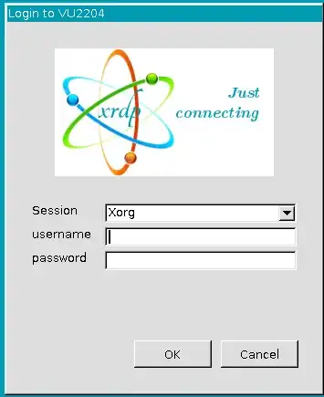

Two points for the XRDP/RDP Client
1. Session, User and Password
When you try to access the remote computer using (X)/RDP, you may see this dialog box on your RDP/XRDP client:
  1. Set Session to XOrg, the default.
  2. Use your remote Ubuntu Computer's username
  3. Use the remote Ubuntu computer user's login password. Do not use the randomly generated password when you set up the (x)RDP client.
You won't see this dialog if you use Remmina and choose to store your username and password with the connection configuration.

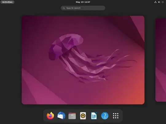

2. Desktop may look different
When I used Remmina to xrdp into the Ubuntu22.04 in the VM, I didn't get the default Ubuntu desktop. Instead I got the Gnome 42 desktop that looks like this:
There may be some way to change it back to the Ubuntu desktop, but I didn't explore that.
To change the appearance of the desktop from the default gnome to Ubuntu, create the hidden file /home/$USER/.xsessionrc with the following content:
export GNOME_SHELL_SESSION_MODE=ubuntu
export XDG_CURRENT_DESKTOP=ubuntu:GNOME
export XDG_CONFIG_DIRS=/etc/xdg/xdg-ubuntu:/etc/xdg
Source: How to login to the Ubuntu (not GNOME) session on a remote server using xRDP?
Thanks to Torres and AgentRev for bringing this solution to my notice.
