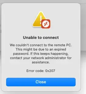

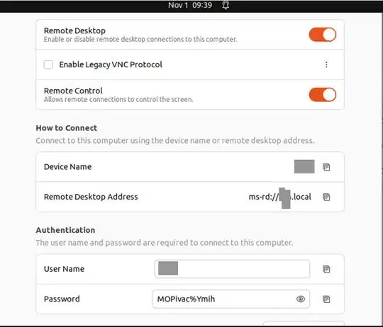

First you might want to note that you need proper authentication - a password is generated which you need to use generated password
otherwise you might see an error message such as:
Error Message

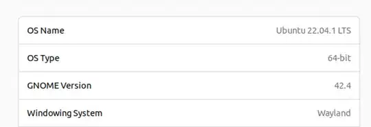

In settings/about i got: Settings/about

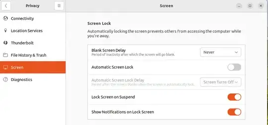

To avoid the session to disconnect itself when the screen save kicks in you might want to change Settings/Privacy/Screen
Screen Share

  1. Check the password you are using matches the one displayed on Settings > Sharing > Remote Desktop under "Authentication."
