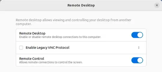

I'd like to be able to login to my remote Ubuntu 22.04 and see the Desktop as shown on that machine. (I know how to create a vncserver with a separate desktop instance).
Built-in Remote Desktop
When I try with the built-in Remote Desktop
it works as long as the user is logged in, the screen isn't locked, and there is a physical screen attached. Requiring the user to be logged in is fine for me, but screen not locked means I can't login remotely after a while, and the "physical screen attached" requirement means I it only works when my KVM switch has the Ubuntu machine active, which also doesn't work for me.
Otherwise I get one of these error messages:
Failed to record monitor: GDBus.Error:org.freedesktop.DBus.Error.Failed: Unknown monitor
Failed to start remote desktop session: GDBus.Error:org.freedesktop.DBus.Error.AccessDenied: Session creation inhibited
But I want to be able to log in and see my desktop when the screen is locked and the monitor disconnected (due to the KVM).
The screen locked situation can be handled by this gnome extension: Allow Locked Remote Desktop - GNOME Shell Extensions, so now only the monitor disconnected issue remains, and for that, I've posted this issue: Failed to record monitor: GDBus.Error:org.freedesktop.DBus.Error.Failed: Unknown Monitor (using KVM switch) (#171) · Issues · GNOME / gnome-remote-desktop · GitLab.

So "Built-in Remote Desktop" does not have support for when the monitor is disconnected (see issue#171 that I mentioned above).
And it turns out that the x11vnc and x0vncserver issues are also about the disconnected monitor.
I plan on working around this problem with an EDID Emulator. I've ordered this one. It hopefully lets the computer think the display is still attached. And then next time I update the KVM switch, get one with a built-in EDID emulator. I'll try to remember to update this thread when the EDID emulator arrives and I've tried it out.
That should allow me to use both the built in remote desktop and x11vnc and x0vncserver. We'll see...
