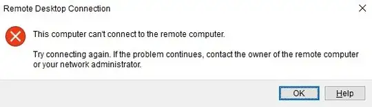

EDIT: attached image of the error
Remote Desktop Connecton ERROR
