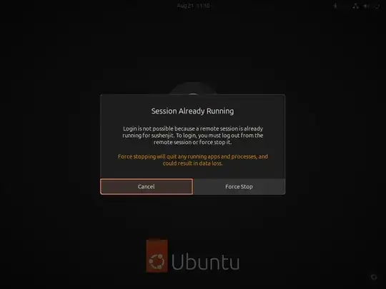

Unlike the Remote Desktop Sharing, when you login remotely using this feature a local intruder will not be able to see the screen on the attached monitor or interact with it. If you are remotely logged in and try to login locally at the same time you will see this message on the local monitor:
Warning on the local monitor
