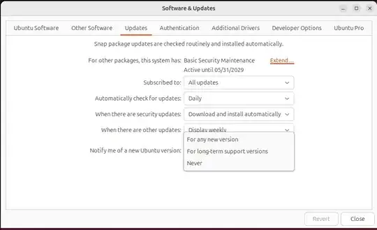

Ubuntu 24.10 comes with Gnome 47. To upgrade to 24.10, open the app Software & Updates and go to the Update tab:enter image description here
Change the Notify me of new Ubuntu version from "For long term support versions" to For any new version. Click close.

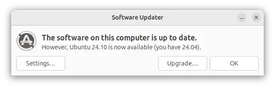

Open the app Software Updater and first complete all the pending updates. Once Ubuntu 24.04 is fully updated, the app may ask you to reboot. Reboot if needed, and open the app again. The app will then offer to upgrade to 24.10:enter image description here.
