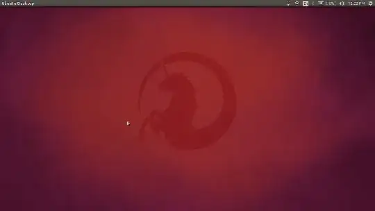

You can use ntfs-config GUI utility to mount NTFS partitions in fstab.
Mount NTFS Windows Partition FSTAB
ntfs-3g driver is required to provide full read-write support for the NTFS partition and gksu to run NTFS Configuration GUI with root privileges.
sudo apt-get install ntfs-3g ntfs-config
sudo apt-get install gksu
Search for and open ‘NTFS Configuration Tool’ from the Unity Dash. In the window that appears select the partitions you want to configure. Here, I would prefer to have only my storage partition mounted. Just tick ‘Enable write support for internal device’.
NTFS-Config Utility will backup the original fstab file, so we can easily review the changes that were made by the application. To review the changes,
cat /etc/fstab-ntfs-config-save
cat /etc/fstab
