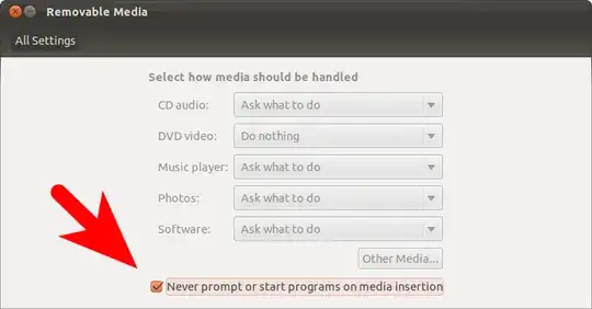

Whenever I insert a flash drive, a new Nautilus window opens showing its contents. Is there a way to deactivate "auto-open" option for a specific USB unit?
Braiam
  • 69,112
go to Dash Home > System Settings -> Removable Media and check "Never prompt or start programs on media insertion"
