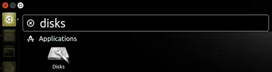

3. Make the partition part of the static file system tree: Disks
1. Open Dash and type Disks:

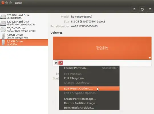

2. Find your target device and select Edit Mount Options:

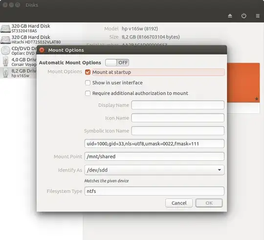

3. Edit Mount Options and click on OK:

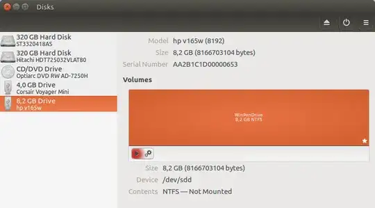

4. Mount the device - click on the Play button:
