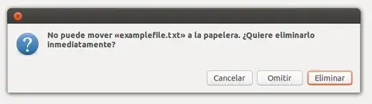

When I want to move a file to the Trash, Nautilus give me an message saying this:
You can't move example.file to the trash can. Do you want to remove it immediately?
I can give you this photo but it's in Spanish
