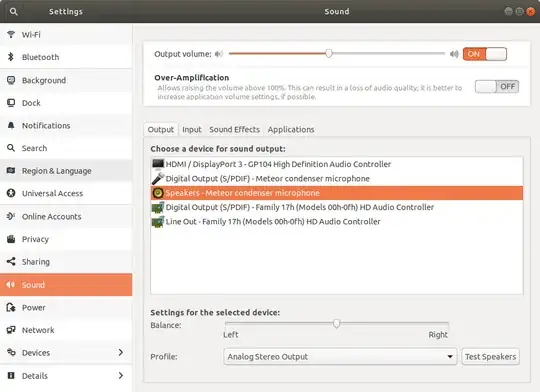

Every time I boot up, I have to switch my audio output device to my "Line Out" headphones because for some reason my microphone defaults as a speaker.
See this screenshot:
See this screenshot

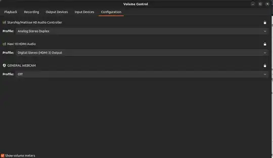

This can be done with PulseAudio Volume Control if you prefer to use a GUI.
Once you've opened PulseAudio Volume Control, choose the configuration (the last tab), then select the output and/or input you want to use from the profile dropdown menu. It should look similar to this
PulseAudio Volume Control can also be used to adjust volume levels for each input, output, system sounds and applications that are currently in use.
