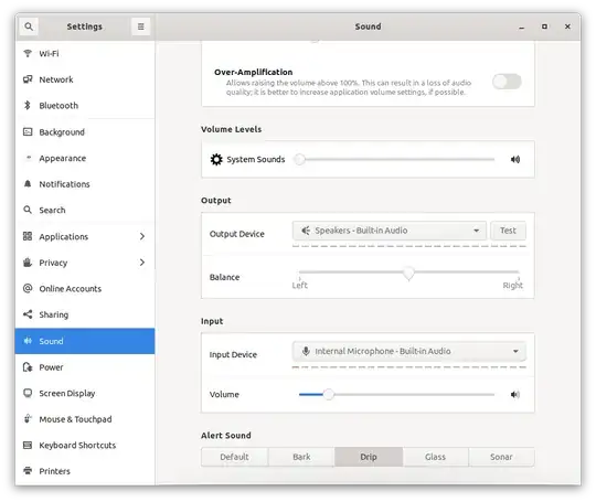

On startup the computer defaults to the USB audio input/output from my dell dock no matter what I do. If I unplug the dock and plug it back in, the input/output devices are set as expected (internal speakers and mic). Is there a fix for startup? I'm using names in the default.pa.
