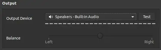

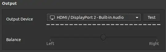

My laptop with Ubuntu 19.04 detected and set my HDMI output on every boot. But since I upgraded to 19.10, I need to set it manually every boot as follows:
From
before
to
after
