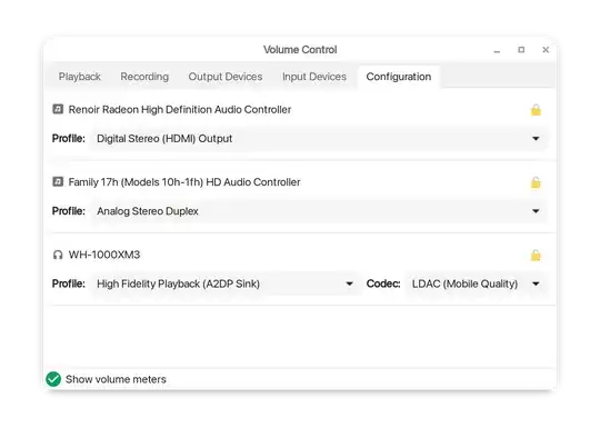

The PulseAudio Volume Control software seems to work for me. I am using Ubuntu 22.04 with Sony Wh-1000xm3.
First install the software with sudo apt install pavucontrol.
Then, open PulseAudio Volume Control and switch the Codec from LDAC(High quality) to LDAC(mobile quality).
Screenshot
