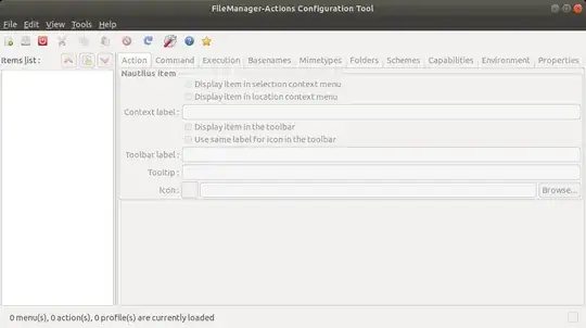

After installation you will get new executable named fma-config-tool, its window is named FileManager-Actions Configuration Tool and looks like:
fma-config-tool on Bionic
