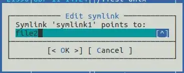

I know that Midnight Commander has File → Edit symlink option, but it is terminal way:
Edit symlink in Midnight Commander
$ file symlink1
symlink1: symbolic link to file2
and it is very useful if target and symlink are located in different file-systems and/or nested folders.

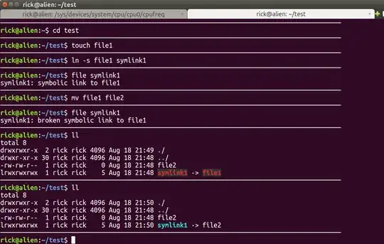

Sample output
This is the test data used. The second last section shows the broken link. Then our script is run giving a new file name. The last section shows the new good link.
Edit Link2
Sample screen
This is what the script looks like when you run it:
  • Highlight a broken link with Nautilus
  • Right click for context menu
  • Select Scripts
  • Select edit-link
  • Enter new file name above and click OK button
