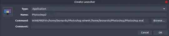

However, say I wanted to have a shortcut on my Desktop that launches this command.
I create it like this, I double click it, and it just gives me this error
This happens with pretty much every single application I try to create a shortcut command to.

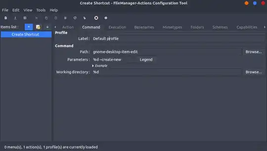

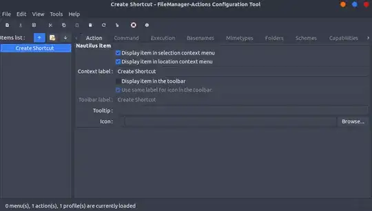

  1. Install the correct filemanager-actions you need by following this guide (the default Ubuntu file explorer is Nautilus)
  2. Run fma-config-tool
Then just set it up like this:

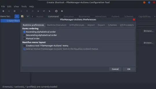

This will add an option when right-clicking inside Nautilus that will bring up the Shortcut creator app to add a shortcut in the current folder. This option will be in a sub-menu by default, but you can go into Edit -> Preferences -> Runtime Preferences and deselect "Create a root filemanager-actions menu"
