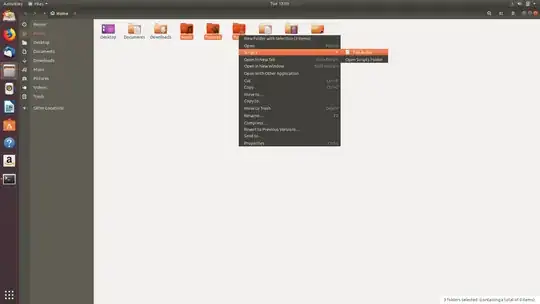

After that you can see File-Roller option in right click Scripts menu.
File-Roller
