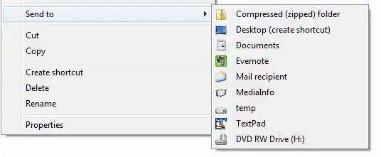

I have tweaked "Send to" options in windows explorer. See the screenshot below:
Screenshot of Windows 7' Send to menu
