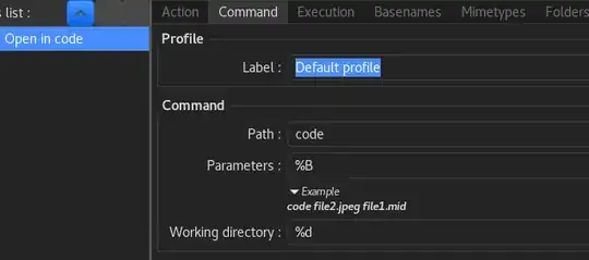

What you need to do is install Nautilus Actions
sudo apt install nautilus-actions
and add new action :
Path: code Parameters: %B
command
in menu

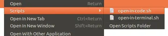

1.Create a file ~/.local/share/nautilus/scripts/open-in-code.sh with this content:
#!/bin/bash
if [ -n "$NAUTILUS_SCRIPT_SELECTED_FILE_PATHS" ]; then
    set $NAUTILUS_SCRIPT_SELECTED_FILE_PATHS
    if [ $# -eq 1 ]; then
        destination="$1"
    else
        zenity --error --title="Error - Open in Visual Studio Code" \
        --text="You can only select one file/directory."
        exit 1
    fi
else
    destination="`echo "$NAUTILUS_SCRIPT_CURRENT_URI" | sed 's/^file:\/\///'`"
fi
# It's only possible to go to local directories
if [ -n "`echo "$destination" | grep '^[a-zA-Z0-9]\+:'`" ]; then
    --text="Only local directories can be used."
    exit 1
fi
exec code "$destination"
2.Add execution permission to the file:
 $ chmod +x ~/.local/share/nautilus/scripts/open-in-code.sh
3.Restart Nautilius.
4.Right-click on a file or directory, you will see this:
open in nautilus
Source: https://help.ubuntu.com/community/NautilusScriptsHowto
