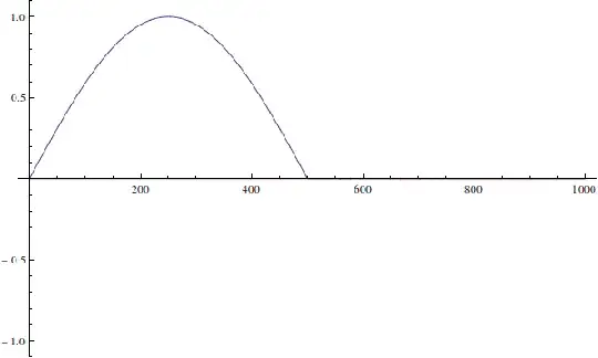

...it makes no sense to calculate any property of the particle with the "initial" wave-function, since this is simply the incorrect wave-function for the new well?
The wavefunction can't be "incorrect for the well". Your wavefunction is just an initial condition for time-dependent Schrödinger equation. Here's how it would evolve if you solve the time-dependent equation (I ignore normalization here):
