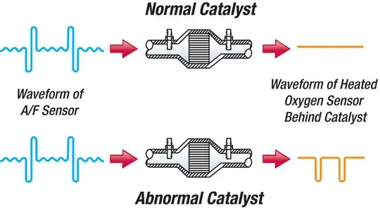

  2. Consult the lambdas
    The big caveat with this approach is that it assumes the lambda sensors in question are healthy.
    In narrowband setups, the voltage output of the pre-cat lambda sensor should flit between 0.1 V (lean) and 0.9 V (rich). Since the chemical reaction inside the cat consumes oxygen, the post-cat lambda should show a stable signal which corresponds to a rich condition.
    The image below summarizes the expected results.
    Lambda probe test
